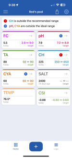

So my levels are here below. My CH actually went down from the last time I checked it. Previously I was told that there was no need to add any CH as by end of summer it will go up on it’s own, but my levels have stayed between 225-250 since Feb when I added the CH initially given that my first fill water only gave me a 50 level CH. Is that advice still solid or should I add some?
My CYA was 60 . Since temps next week are back in the 90s, should I look to add more CYA to get it a little higher or still wait?
My pH is always high, but I guess that is going to be the case all the time until next year with new plaster. I have to add muriatic acid at least every other day. Is that fairly normal?
Suggestions from you pool pros always welcomed and appreciated!
The CYA should be minimum 70 and better would be 80 and with that is a FC target of 5-10 for 70 and 6-11 for 80 and try to stay no lower then midrange of target. If your fill water is that low I'd say up it another 50 ppm but be sure that your water supply remains that low before bringing it up. Your salinity is low @2400 and needs to be in the 3000 territory at minimum but be sure that's what it really is so you don't overshoot.

Well my CH still hasn’t gone up.
Actually it went down by 25 and is 225. Still think it is going up on its own?or add some CH?
It will rise. It did not go down, that is testing variance.
Add calcium if you wish.
By the end of this summer, your CH will be close to 400 ppm naturally due to evaporation.
