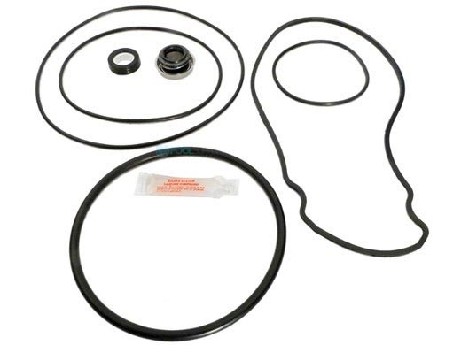

Yes it is easy. What is the make and model of the pump?
PoolStored
Jun 24, 2021
3,441
Ashtabula, OH
30000
CircuPool RJ-60
It’s a Pentair intelliflo VSF (356903.A)
Search google for "Pentair intelliflo VSF go kit." This is a kit that includes all the o-rings and seals you need, including the shaft seal. The kit is cheaper than putting the kit together yourself.
It will include the shaft seal, but there are different levels of quality:
The go kits typically include the ps-1000, they are servicable, but I've had problems with both the basic service and premier. If you can afford, it, buy the PS-1905 in addition to the one that comes in the go-kit and keep the go-kit shaft seal as a spare. It is pricey, but they last longer.
Here is a good place to get them and good price -->
Finally, here are the instructions, straight from Pentair on how to replace the shaft seal. Go!
