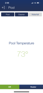

Show me a pic of the EasyTouch's display when the system is in AUTO and the main pump and booster buttons are on (red)
At the same time, look at ScreenLogic and see if there are any delays or alerts on and what speed does ScreenLogic say the main pump is running.
Jim R.
Yes the pump is brand new, 4/18/23.
The light is on on the easy touch. The booster lighted up but then it shut off. It keeps trying. But the light on the easy touch is still on and the app shows it on.
