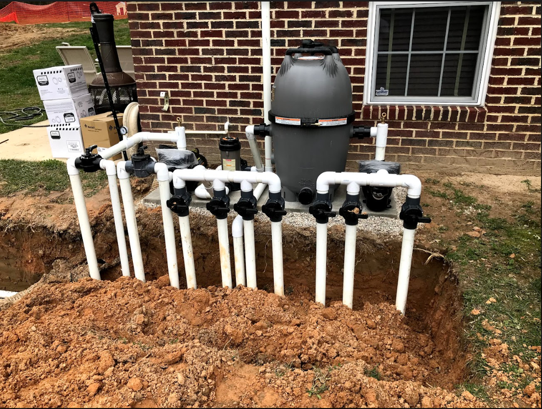

Which erosion feeder do you have? Pic of the set up?
