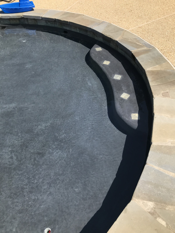

In the meantime, we've been enjoying the pool immensely. The color is absolutely perfect and I cannot imagine what it would've been like had we not sprung for the insanely overpriced dye. The water temperature is easily in the high 80s at this point and with both skimmers it is staying pretty clean. I do need to vacuum it manually and just received the vacuum today from the builder. I think I've decided on a Maytronics Active20 but obviously still can't use it so I haven't ordered it yet. The builder said to wait at least two weeks for plaster but everything else I've read says 30 days so I will probably wait.

Wow, that water looks so inviting! And that color!
