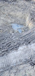

We just got to the bottom of the hopper and hit ground water. No water coming in from the sides. It's not a big issue to over excavate, add 18" of rock to the bottom of the hopper and add a dewatering pipe, but has anyone installed a removable sump pump more permanently in the dewatering pipe? It would be like a basement sump pump, I'd just need to get a waterproof outlet box to the dewatering pipe location to plug in the sump pump. Maybe it'd be more hassle than just dropping a sump pump down the dewatering pipe, but I don't know how often or how fast the water will come in so a more permanent solution would be better and I could handle it now while it's early in the pool build. I was already planning on running drain tile around the pool at the height of the shallow end, from the high side of our yard to daylight at the low side of our yard, but that drain tile is 54" above the hopper depth and won't catch the ground water. I was installing the drain tile because the houses east of me go up hill and the houses west of me go down hill.... 1st pic is when we initially hit water, 2nd pic is next morning, it doubled in size but froze over night, might have gotten bigger if it didn't freeze.

I would construct the well points so that you can have a sump pump with a float switch to keep the liner from floating if necessary. You don't know how much the underground water will be a problem once the pool is installed.

I believe we're on the same page. The water didn't show up until we hit the 8'-8" hopper depth, I've got the excavator taking out an extra 24" in the 6'x8' hopper. I'll place a ground water drain in the middle of that area, fill with rock, pipe the ground water drain to a large vertical pipe for a sump pump, the vertical pipe will be finished off at the concrete pool deck with a skimmer cover. I'm wanting to run a pvc pipe from the large vertical pipe under the concrete pool deck to a point at my wood deck where I have an outlet, then I could pulg in the sump pump there. Then I'd run another pvc under the concrete pool deck to daylight for the sump pump drain hose. I'm trying to set this up so I don't have a sump pump drain hose and power chord running across the top of the pool deck.
I'm also going to add a hydrostatic valve to one of my main drains. Is the valve sufficient or do I need a perforated pipe into the rock bed?
