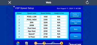

Reduce RPM 100 at a time until your SWG shows NO FLOW. Then add 300 RPM and that should be your pump low speed setting.
Add 400-500 RPM and that should be your pump high speed.
See how those speed work and then tweak them up or down.
