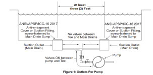

What make and model are the main drain fixtures?
What is the main drain line size?
You can add main drains to the walls if you want to add a second pump.
I would want plenty of surface area.
I would have a total main drain rating of at least 240 GPM, which might require 4 regular main drains.
Maybe do 2 sets of wall mounted main drains with 2" pipe from each drain to a 2.5" T and then (2) 2.5" lines to a 3" manifold at the pump.
You will need to core drill out the holes to add the main drains.

  • starguard-main-drain-brochure-english.pdf
