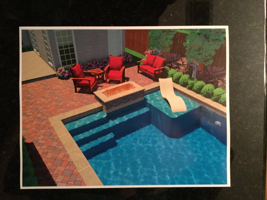

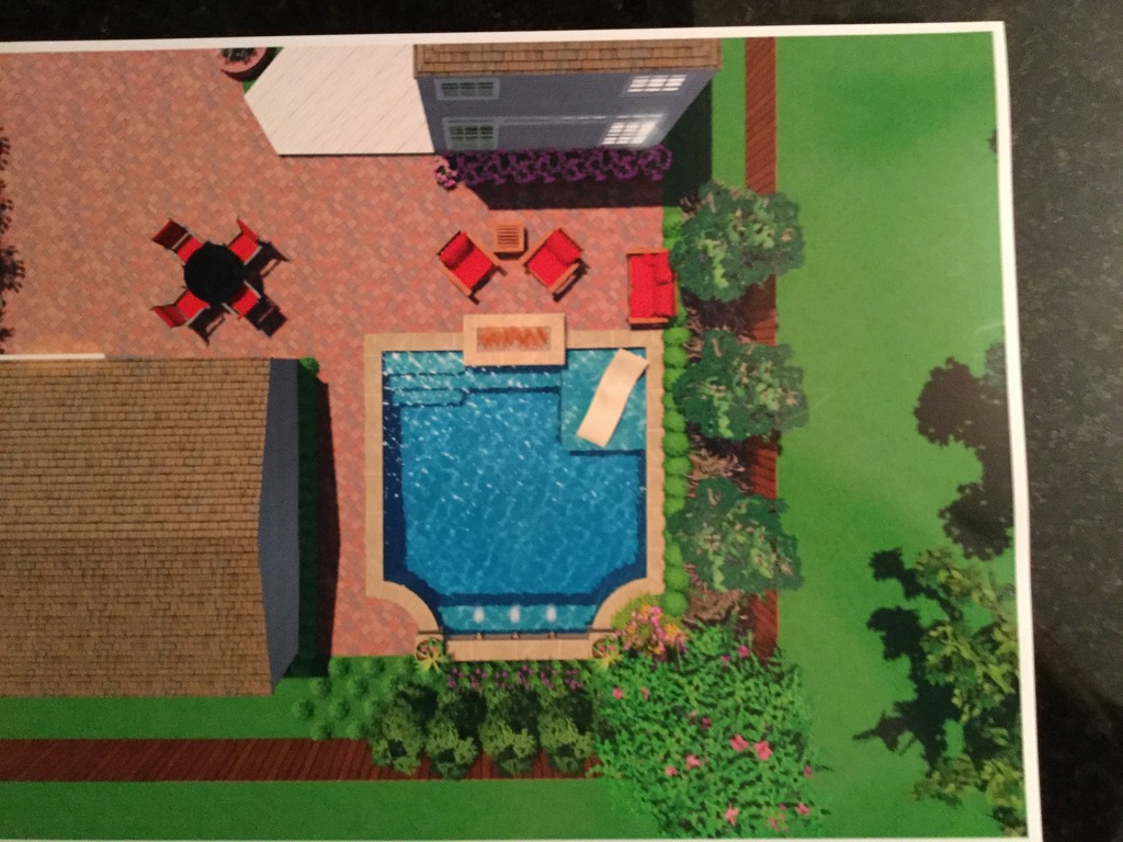

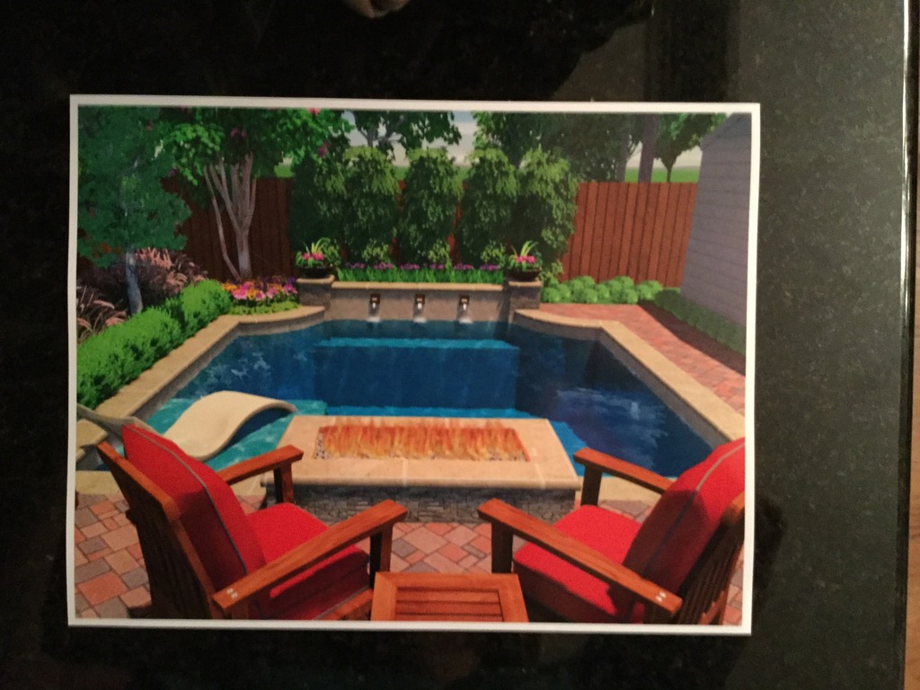

We met with PB 3 last night. Here is what he came up with.
We are making a few adjustments - back wall a bit taller and enlarging the fire pit back towards the deck.
Thoughts?
Sorry I should have cropped the pictures. He gave us stills of his design and I then took pics so I could post.

Thanks Helen! We really liked it too. He hand draws it or at least sketches it and then scans it into Pool Studio instead of designing from Pool Studio.
Ohhhhhhhhhhhhh I love this design also! WOW! This is going to be a tough one to pick!

Beautiful design!!! This just proves that Great Things come in small packages!!
I love the water wall and the corners on either side. The PB really packed in a lot of goodies. I like the design of the in-pool benches and steps - great seating spots while keeping cool.
What are your thoughts about this design?
Suz.
Thanks Kim! I really like the simplicity of this pool. It's only about 18x16-6! though. What do you think about the water effect? The spouts instead of the sheer descent? I think the spouts are quieter? I didn't ask about the material for them. I know I don't want to put any metals into my pool! Thanks TFP!!!

Marla there is a pool where they had a water feature.............it was several holes in a pipe kind of feature. It was too loud to them. The PB went back and cut the holes into one long line so it was a water sheer and THAT made the noise much quieter and softer. They love it now.
So three water points might be too loud for your area. I don't know for sure. Is there any way you could ask him if he has a pool with a sheer and a pool with 3 or 2 outlets so you can go listen to them?

For the size: In my foggy memory, didn't you mention going for closer to 20X20? You guys are the only ones who know what you want most for size. I know you know this from all your TFP research, but you have to weigh how much deck space you need versus water area. It's always hard for me to 'feel' space from the design drawings. In the third picture down, it looks like you have just enough deck space for the furniture - it seems to be a good fit and use of space. In the first photo of the overhead view, it looks like you have more wiggle room to stretch the pool a foot or two closer to the house. That might mean keeping the fire pit the same size rather than enlarging it. But what do you want more of - fire or water? Lol!!! I'm such a water girl, I gotta have every extra inch of water I can get!!! It also looks like you might be able to stretch the pool closer to the garage (I think that's the garage). There's not much use for that space except as a pathway. I would want it only wide enough to get a mower or wheel barrow through there.
On the other hand, if ya'll entertain then you have to consider how much deck real estate you need. I could have managed with much less deck than I have (I'm the opposite of most people) and squeezed out more pool size.

We might be able to get another foot out of the pool in both directions. I do want a lot of landscaping on the fence side (I think he allowed 5') opposite the garage because they are building a ginormous house and need the screening. We might be able to cut back on that some. We do some entertaining, but would also like to get as big a pool as possible but still have nice deck space. I think the path by the garage is 3', coping is 1' and he allowed about a foot for planting small grasses or liriope type plants next to the garage to soften the space. We might be able to make that smaller.

Here's a photo of some water spouts. This was my first inspiration photo - I love the spouts! I think these would be perfect for your pool. MasterTile and Noble Tile (along with other tile sources) have some gorgeous spout facings. I liked these the best. I can't say about the noise level. I've seen pictures of the larger square and metal type spouts. Surely the little guys in the photo wouldn't be as loud. It also makes a difference how long of a drop the water has to fall.
I do know that many of the water features are so very loud. I didn't quite think they would be as noisy as everyone says (duh.....), but they are. I turn ours on for view when we're in the house, when I'm outside by myself or for brief periods to show with friends. Would I get them again? Absolutely!!! I do love them.
