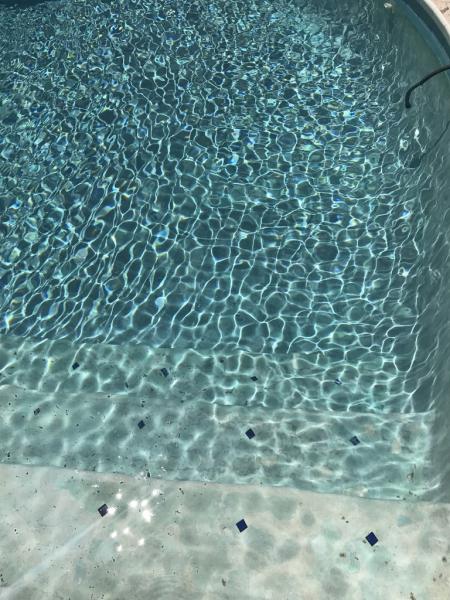

Project Lower TA still in progress. Started at 140, hovering between 100 and 110 now. Color change starts at 100 and fully saturates at 110. Progress! What's my ultimate goal? I know the 'range' is 70-90. Everything else is on track.
Step pics really aren't needed anymore since I'm not in slam, but I couldn't resist sharing this one. Aerator causing ripples in the pool made for a cool picture.

Nice! Looks like glass beads. :thumleft:
Ultimately, your overall goal is to keep CSI within the proper range for plaster. But I believe your current goal is to lower TA until pH rise is held to a slow rate.

DUDE! You have SPARKALICIOUS WATER! That is one GREAT looking pool!
Did you ever think your pool could look like that?????????
TA/PH-your pool will tell you where it wants the TA to be. Start at 90 for you TA. Let it ride for the week. Does your PH stay stable for the week? If PH goes up during the week then push the TA down to 80 and try again.
I will also tell you that some pools likes the PH at 7.8 or so.
This is where keeping a good log comes in. That will show you what is what.

Yep, that's some nice looking TFPC water right there. TA is stubborn Numb. It's strong for a long time, but it will finally break for you. I don't remember your makeup TA, but this is something you're likely gonna fight from now on. Mine is 130 or better from my well, so its a lifelong battle around here.
Like :kim: said, you may find a sweet spot for your pH, and hopefully you will.
