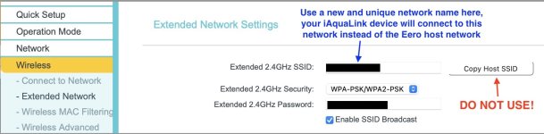

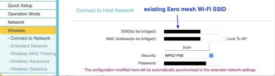

It is critical that you configure the TP-Link device to generate its own unique SSID (network name), rather than simply re-broadcasting the host (Eero) SSID. This is an option you must configure in the setup of the TP-Link device, because the default is to re-broadcast the existing SSID which is not what you want (that would mean the iAquaLink device might see even more nodes with the same SSID which would exacerbate the existing problem). Here are screenshots of the relevant TP-Link settings to do this:
Connecting TP-Link to your Host Network (this is your Eero mesh network):
Creating the new (extended) network for your Jandy / iAquaLink device to connect to:
Once you've got this setup, you should see a new 2.4 GHz Wi-Fi network with the SSID you've just specified. Before you touch your iAquaLink equipment, try connecting a few 'normal' devices (phone, tablet, Mac/PC, etc) to this network and make sure these devices have a valid internet connection using this extended network. Then, after you've done that, you can re-connect your iQPUMP01 / iQ20 device to the new extended network using the normal documented approach for those devices.
