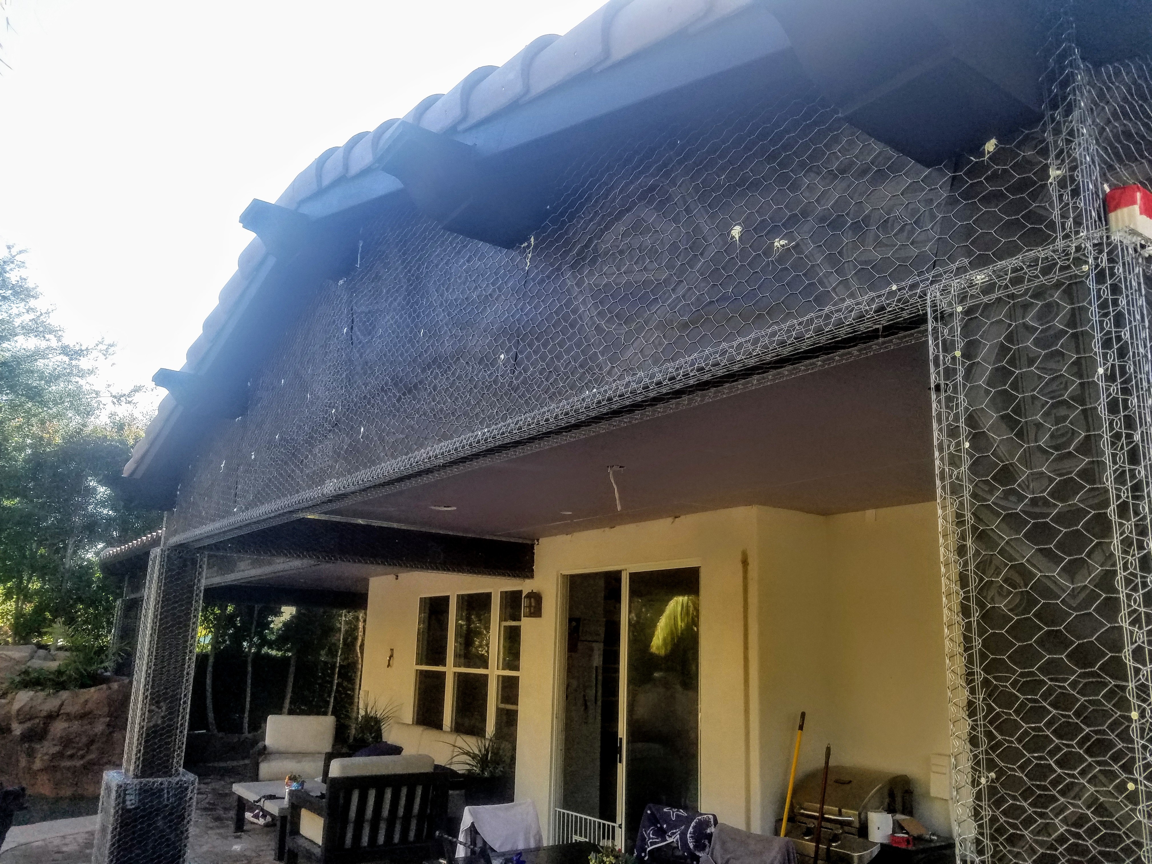

Brian, how hard is it to work with that chicken wire to form everything? It looks like metal rods forming the corners and hooking everything together? :scratch:
The framing gets wrapped with building paper and then the lath gets rolled out and stapled in place with 1.5" crown staples every 6". The corners are then nailed on to give straight edges and set the appropriate thickness for the stucco.
The wire rolls are heavy, the paper rips easily and your hands are constantly bleeding from getting poked.... other than that it's easy peasy?
