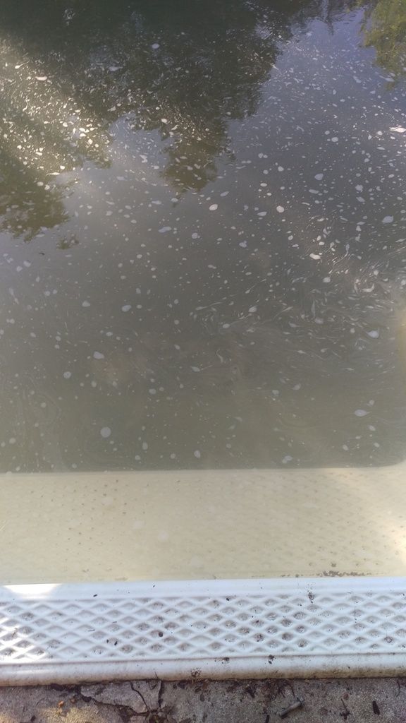

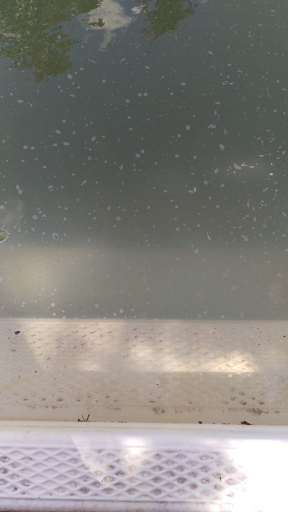

If you are not seeing color change of water, I feel there is something not going quite right and would like to see some fresh pictures and maybe have you hold a white piece of cloth in front of a return to determine if the water coming out of return is clear or has sand in it.
We've recently helped someone with a no-progress swamp resolve by determining they had broken laterals in their sand filter. So this may be a good check. It would help us to know if visibility has cleared at all as well.
