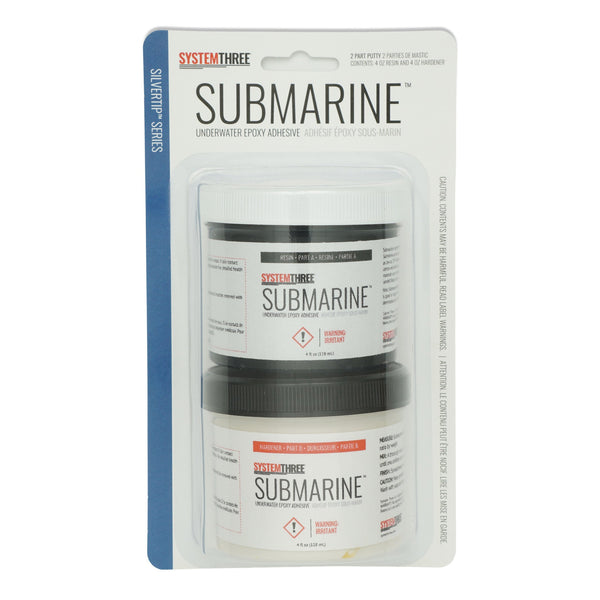

Maybe an epoxy like PC-11, Plast-aid or others.
