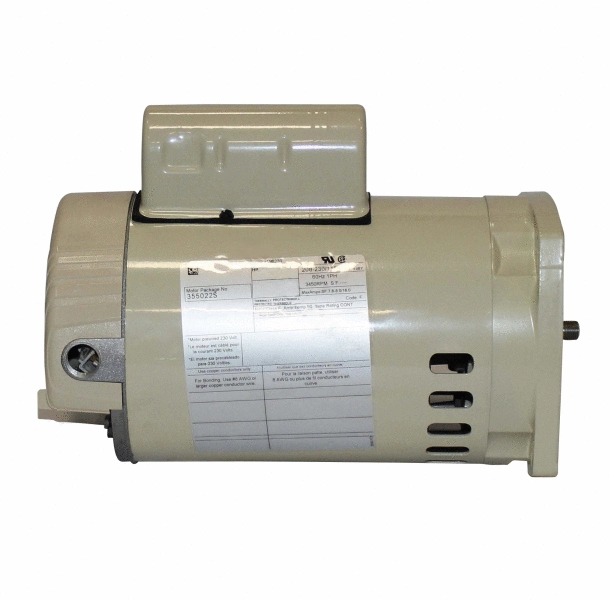

Motor
The Pentair 355022S 1HP 115/230V Almond Square Flange Motor is an excellent choice for your pool needs! Get yours today from Pool Warehouse!
