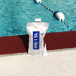

I used this. Extremely easy and convenient. First mix the contents by squishing the bag for about 3 minutes. Cut the tip and squeeze the contents into the expansion gap until level with the coping / decking. The case I got had six bags. I used 5 1/2 bags to complete my 118’ perimeter pool / spa. Took about an hour to complete.

Thanks for this tip! This looks much more convenient than their two-part product that must be mixed and then loaded into an applicator. Do you have any feelings about the relative life of the two Deck-O-Seal products (one appears to be air/moisture curing and the other a two-part curing process)??

ps I've been looking over the Deck-O-Seal products and I think Spookie's recommendation for the HS-1 SL product is the least hassle. But, it is air/moisture cured vs the other product by Deck-O-Seal which is a 2-part product (more hassle with mixing and pouring). My only question is the relative life of the two products. Is the 2-part stuff worth the extra hassle?? And self-leveling is DEFINITELY an issue!

I have done my pool twice now and have used both the Deck-O-Seal one part pouches and the Sika Flex self leveling caulking tubes. I think the Deck-O-Seal is a much better product and it hasn't cracked or had any other issues that the SikaFlex exhibited pretty quickly after my first attempt with it in 2015. I redid 2 sides of my pool in 2018 and it still looks great. I still have one side of my pool to re-do at some point and I will only use the Deck-O-Seal product.

One other tip. They don't tell you this, but the top of the sealant bag has a little plastic ring underneath the threads of the cap. You must cut the white ring off of the bag with a carpet knife or pocket knife before the nozzle will screw all the way down on the top of the bag. Otherwise the nozzle won't screw on all the way, causing a leak. Annoying. Also, just cut the nozzle off as far up as possible. You will need that level of flow of sealant out of the bag.
