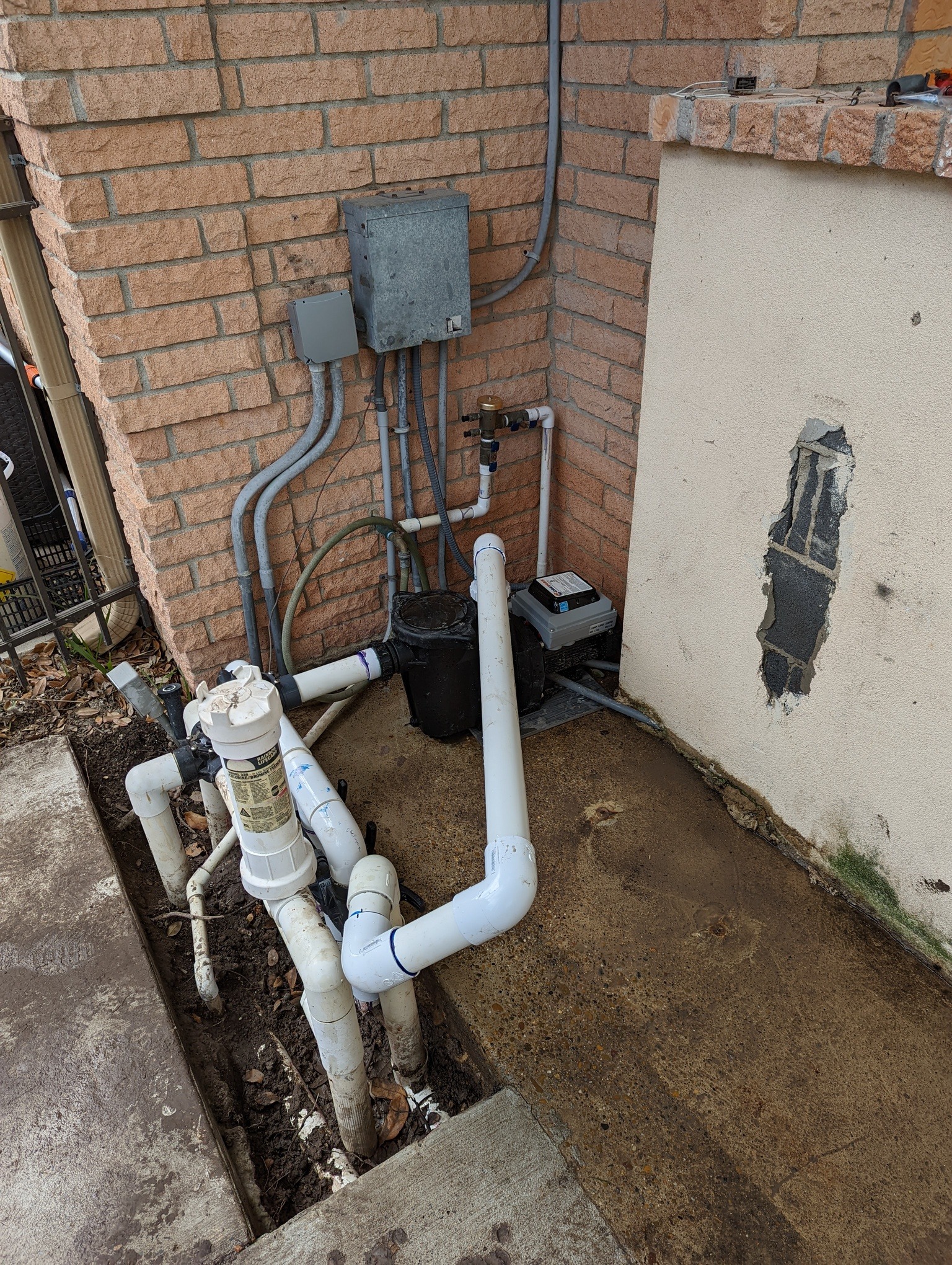

I would like to clean up the plumbing while I am replacing all this equipment. Here is a photo of the existing setup:
I am excited to get rid of the timer. Big X across that.
Red frowny face on the loose flag stones holding the motor and pump in place. I hate this the most.
I really want the pump area to look smart and well laid out. Problem is, I dont know the first thing about designing this stuff! I highlighted the supply/return of the pump in green. Is there an optimal way to route?
I love how compact and stable something like this looks: Perflex | Filters | Above Ground Pool Filters - Hayward Pool Products
Wondering if there is any reason my setup is the way it is and what rules to abide by when upgrading.
Wow. Thanks for all the great advice and links.

Totally understand that this is the wrong filter/pump for my application but I pointed it out as it is such a compact design and I would like to clean up the pvc that I have with something cleaner. Mostly want to delete the wobbly platform the pump is riding on.
I know this will sound crazzy but it really is easy.. Cut the pump and filter out and take the PVC back to an easy place to start.. Put your new pump and filter where you want it and then start connecting it up with the best possible layout... You can move the pump and filter any place you want..
Cut the along the red lines and pull the old pump and filter and all pvc out and start from scratch.. :)
It looks like the pump was raised to accommodate the suction plumbing. You may want to stabilize the platform the pump sits on so the suction plumbing is straight into the pump as it is now. You never want to have the suction plumbing to be above the pump inlet and then come back down. That is very poor hydraulically. Every pump manual will say this. The valves in what appears to be the pool suction line may not allow the pump to be placed much lower.

The old filter finally cracked to such an extent that we could no longer move water. I am still waiting on shipping for the replacement filter but I want ahead and installed the new pump just to avoid losing my pool to algae. Running sans filter at the moment but pretty excited with the new pump. So much quieter and seems to be working as expected. Cant believe I glued up that many couplers without messing something up!
I was able to drop all the heights down so the pump is sitting on just on piece of leftover tile instead of the leaning tower of flagstone from before.
