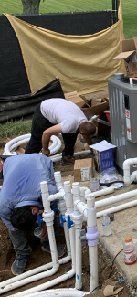

Is your pool plumbed with flex PVC? Unfortunately fiberglass pool installers like to use flex pvc.
It can indicate a restriction in a suction line pipe and your pump unable to get the volume of water it needs.
Your pool could be developing a problem like @Casey had. Read...
This is about the only pic I’m finding (hub prob has more ) maybe this does look flexy . The gray handle is the main drain, immediately left of it is skimmer IMG_6490.png
Yup, looks like they used flex PVC is some places on the suction lines.
