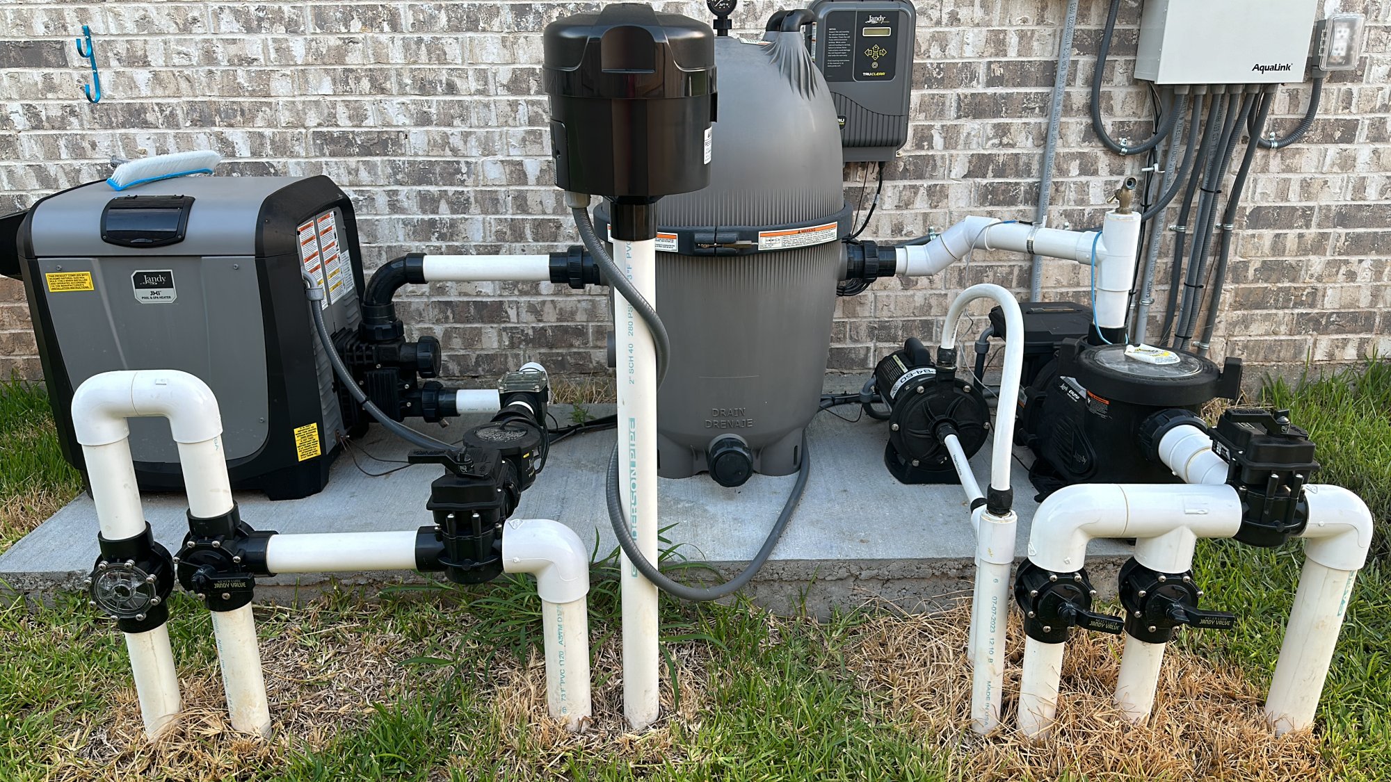

That valves corresponding to spa mode. When I turn spa mode on valves rotate to on and pool valve rotates to off. Just one pump for pool and spa. So when spa mode is on the pump just works for the spa, when pool mode on , pump works for spa and pool. I am no talking about spa mode, I am talking about pool mode. I set up speed to 1750 and pool mode, and worked really good, water had been circulating in pool and spa, perfect! But after 20 hours working well, pump lost pressure and now water is not circulating in the spa, just in pool. Jim explained to me that bc of the heater and a big loop in the circuit , pump probably would need to run no lower than 1500-1800, and I could open a little bit more the valve that controls how much water goes to the spa, to get water circulation in spa. So that’s what I did yesterday, and everything looks work correctly but pump started loose pressure more and more, , look like speed is lower, but I didn’t change anything. So the question is why it was working and suddenly it stopped .

Hello again!! I thought I got it, but looks like I didn’t. I cleaned the filters last Saturday, and the pump was working really good, to low speed, 1500, 24/7, my Swg working as well, water circulating in pool and in spa, until last night, no water circulating in the spa. It was working for 4 days in arrow 24/7 without any problem, and now without apparent reason the water in spa in again no circulating.
Do you have any idea?

Ok, I will do it again if not raining, bc probably tonight it’s gonna rain. Anyways I just turned off the pump and turn on and now it’s working, water is circulating for the spa, i guess until it loss pressure again, right?
Bc, is there any other reason why pump loss pressure, or just algae? Nothing to do with the speed?
But I didn’t change the speed, still 1500.
The only thing that I did yesterday when the pressure was lower, it was turn the cleaner on. When the cleaner started working pressure went down. But, I have to say, that cleaner speed is higher 2000. So, I read that supposedly pump get the higher speed at that time, so it should be work at 2000 , both cleaner and pump, is that correct?

TL:DR has a pool pump and booster pump. I suspect the booster source is connected to MD or Skimmer line. When he turns on the booster, he looses pressure in the spa (because of language barrier, I would confirm this). I don't know enough about aqualink to help and ask the right questions about how it is configured and how the OP is using it to confirm my suspicion that the valves are closing the spa when the booster is running. Original issue was the loss of pressure in the spa after 4 days. Ran cleaner at the same time he lost pressure. Turned everything off and on pressure came back. I don't think it is algae at this point, finished slam and has maintained FC.

You should not run the cleaner when in SPA mode. Only run the cleaner when in POOL.
The cleaner booster pump steals water from the pool return before it goes into the pool and uses it for the cleaner. In SPA mode the POOL returns are turned off. Because your pipes are buried I cannot tell exactly where the booster gets its water from.
Running the cleaner when in SPA mode can damage the booster pump or the diverter valve.
But basically your spa pressure was lower with the cleaner on because of the water the cleaner booster was stealing from the spa flow.
