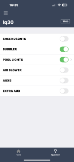

My pool lights suddenly stopped working. I have searched the forums and found the wire diagram for the PX300 and my understanding is I should see 120v on one side and 14v on the low voltage side with the lights turned on. With my lights on I see 8v and basically nothing on the low voltage side. Would this mean transformer is bad or perhaps something downstream like the iAqualink? Or am I even talking the voltage readings correctly? Thanks for any insight!!
