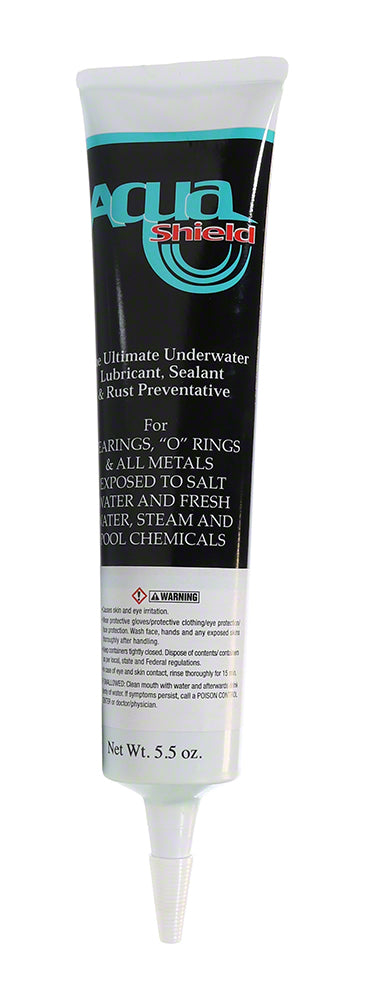

Appreciate the advice. Do you think super lube would work rather than pool lube? I already have a tube of super.

Try this, yeah its pricy, but a little goes a very long way. I go through about a tube a year, but deal with many pools during that time.
