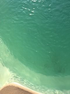

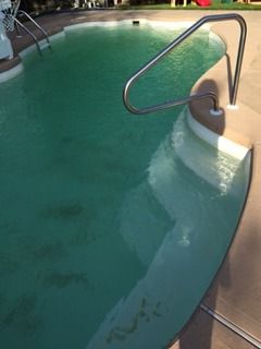

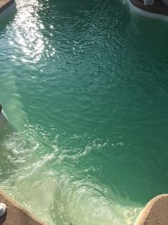

Looking A LOT better!!!! Can see bottom now! Just want to get that brown stuff up and help it not be green.

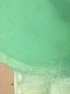

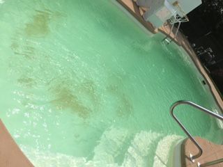

So from this reading, I won't add any bleach. The pool is lighter, but still green. Here are a few photos. So I keep testing every few hours - I keep doing this until the water is clear?

Chlorine is consumed in two ways, by the sun and by breaking down organic material in your water. The fact that your chlorine level is constantly dropping, plus the visible algae shows us that whatever is growing in your water isn't all killed off and removed. We are replenishing the chlorine as it is used up to MAINTAIN a chlorine level that is high enough to kill the algae faster than it can grow. Towards the end, once your water clears up, we will then eliminate one of the two items that consume chlorine by testing the water overnight when we preform an Overnight Chlorine Loss Test ......but until your water clears up greatly we won't worry about that just yet.
For now the "trend" I notice is that you are losing a good bit of chlorine from hour to hour. Seeing that, plus the CC level over 0.5 (your level is 1....keep adding drops until NO visible change occurs),plus the visible water color shows us you still have algae in your water that needs to be broken down. How much longer will this trend last, I don't know.....
