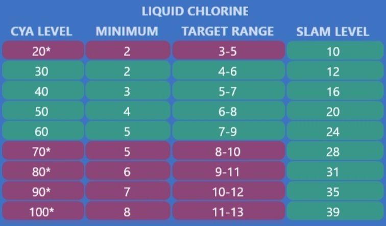

My recommendation is to get a proper test kit. Review Pool Basics and study the relationship between CYA and Free Chlorine.
Pool Care Basics
Test Kits Compared
FC/CYA Levels
Phosphates are a non-issue in a properly sanitized pool in almost all cases. You're not better off with a Spin Touch, than you are in visiting the pool store. The tests just are not accurate or precise enough for proper pool care. Drop-based titration is fast, economical and accurate. 1,000 ppb phosphates is actually fairly low.
With enough stabilizer and proper free chlorine levels, you'll be able to leave behind all of this trouble you're experiencing. Without enough stabilizer, UV from the sun will drop your FC levels. Without enough FC for your CYA levels, organics like algae will drop your FC levels. It's really that simple.

Low FC and high phosphates can lead to algae growth and that algae will eliminate all your remaining FC.
The experts on this website believe that you should kill the algae with chlorine, and it sounds like you are just trying to kill the algae by eliminating its food source (phosphates).
From what I understand, if you SLAM, drop test and maintain a higher FC levels then the pool should be fine regardless of the phosphates. The algae can't eat the food if it's dead.

How can you claim to be following TFP methods if you're consistently keeping your FC well below the minimum for your CYA level?
