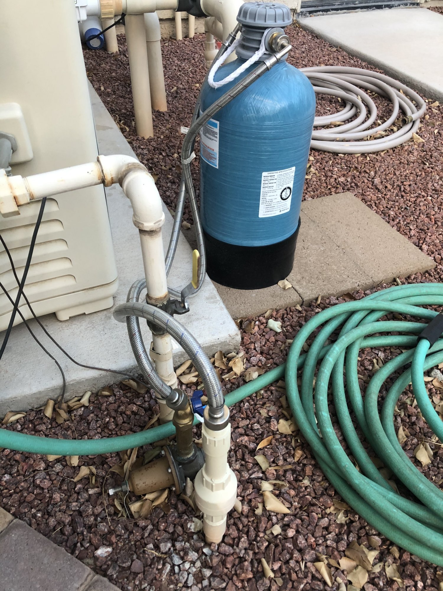

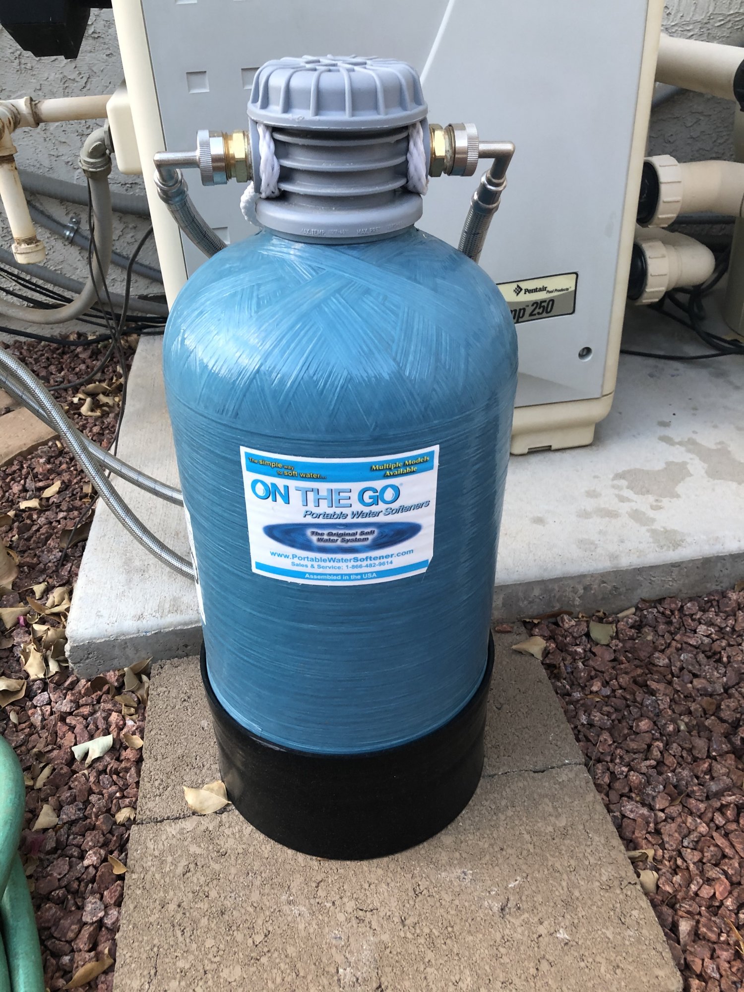

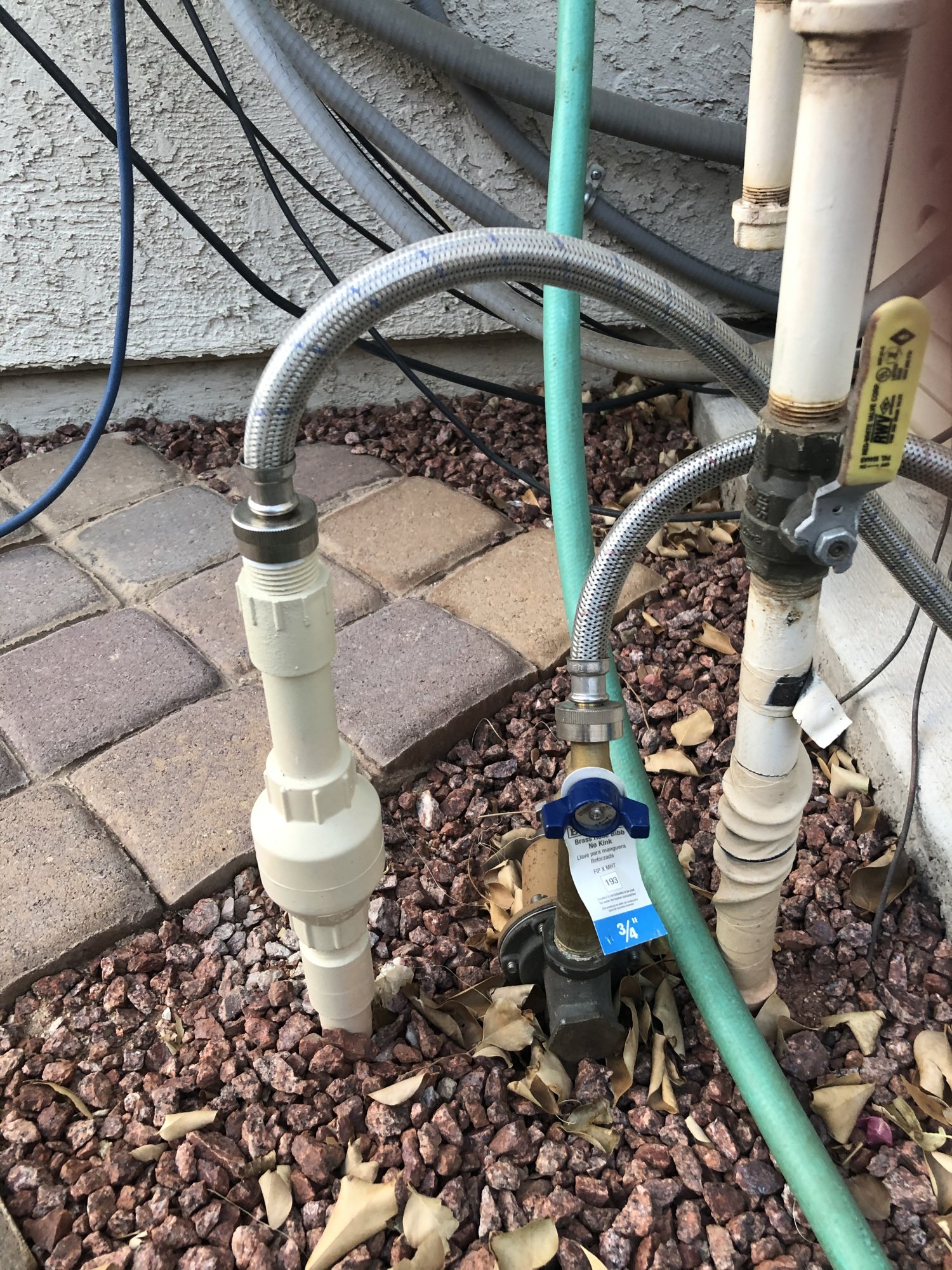

I tapped into my autofill line just past the backflow/regulator. The portable softener uses garden hose connections.
To transition from the 3/4" PVC to garden hose thread at the supply line, I used two 3/4 in. Slip x MHT PVC Hose Fittings, and connected the softener in and out lines using braided stainless steel washing machine hoses (I used 8' hoses). Because both hoses are female/female, I swapped out the fittings at on the softener to brass male fittings. Note that the threads on the softener are standard pipe threads (FIP).
At the softener outgoing connection, I used a garden hose Y-adapter with shutoff valves. One side is connected to the autofill and the other is used for occasional CH testing of softened fill water. My softener is stored in a pool equipment shed.
