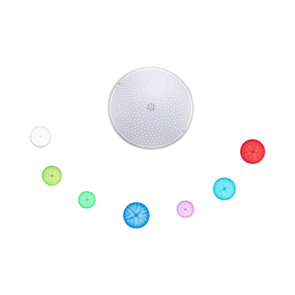

has anyone ever done this replacement? at 269.99 i could do all 3 of my lights for the price of 1 fixture from pentair.
