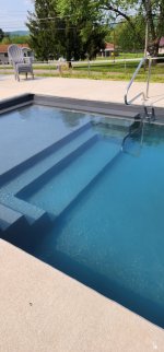

Pool on Monday crystal clear and pool today.
Such a huge change. Pool is 87° too and covered when not in use so it doesn't take long.

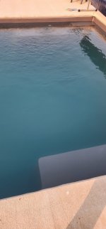

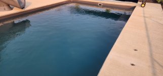

Pool looks a little better but... it's just not putting out like I thought it was. I'm going to SLAM it right now. PB said wait a couple days for salt to dissolve. How long does it take. I added 2 40lb bags last evening n checked it just now n it's reading 2800ppm. It was 2700 yesterday before salt. He says it needs a few days to dissolve fully.
