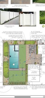

Early in your postings you were talking about an auto-cover, but this design will not support one. As a Los Angeles area pool owner (PV peninsula) I can tell you an auto cover will significantly extend your swimming season I typically see the unheated pool temps are ~10 degrees F higher than the average ambient temp and with the heater I'm often using our pool in January.
On your Baja shelf, since that is the main entrance to the pool, make sure you look at the step height down from the coping to the shelf - you may want to add an entry step? Also, the steps leading from your Baja shelf to the main pool - make sure those steps have a reasonable rise/step (7” - 8”). Also, check to see if you have room for two umbrella holders on your Baja shelf - you may want to change that to one holder centered on the shelf (we originally had two in our pool plans and the PB pointed out (correctly) that there was not room for two reasonable size umbrellas on our shelf which is 11’ wide by 8’ long.
Good luck.
awesome. thank you for the suggestion. will ask about height / and if needed an entry step.
the auto cover was nixed mainly due to budgetary constraints but i totally hear ya. nowadays autocovers are quoted around $20k+ :oops:

I'm guessing that's a waterfall feature of some sort on the left side of the pool as drawn? If so you will want to be sure you get the interlock feature for the pool cover so that the Aqualink knows if it is closed and will prevent the waterfall from running.
I see only one skimmer. Which if you are like me and keep the cover closed when the pool is not in use is probably fine. But if you end up leaving it open all day in the warmer months then a pool that size needs more skimmers.
Also I would ask what the "dual mechanical timer" is for if you are getting aqualink automation.
Regarding the equipment pad it indeed looks pretty crowded to me. Also you should check with your local building department about any restrictions they have on equipment placement. I know my city requires any equipment to be at least 10' from side property line and 5' from the rear property line.

I ended up taking out the water feature so I can afford the autocover 🤣 good looking out as I didn’t get the final drawing yet to reflect this change.
Mostly will keep cover closed whenever we are not in due to little kids. Will ask for one more skimmer (I think pool size ended up being 37.5’x16’)
We will ask for variance to put the equipment pad on that side of the house. It may be a bit tight but there’s really no better place for it.
