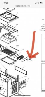

…. You don’t have the shield? It’s called out in the parts diagram.
No, I dont have it - not on either of my two heaters (I will look again tomorrow but I am pretty sure). This is the diagram I have followed and its not on that one - but I found the diagram you sent in my manual as well. I wonder if the lack of this part is the cause of my problem.
