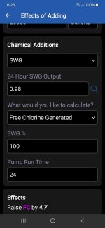

In Pool Math, the Effects of Adding tab will calculate the amount of FC your SWG should generate given runtime and power percentage. Yours is capable of 2.5 ppm of FC in a 24-hour period. That is likely not enough to make up for daily loss during swim season.

My previous screenshot was for the T3. This is for the T9. It should give you 4.7 ppm of FC in a 24-hour period.
