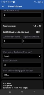

CYA 40
FC was 8
Added 2 gallons of bleach as per the app.
Retested FC after an hour, 22!?
SWG is off.
Could the bleach concentration have been off somehow???
44 drops wiped out the last of reagent, more won't come until Monday so... Yeah.
2 gallons of 12% liquid chlorine would raise your FC by 11ppm.
What did you think it would do?
  • Test error. Clean your vial with Alcohol, bottle vertical, slow drops...let them fall on their own weight. If you squeeze them out fast, smaller drops, higher result.
  • Use a speed stir, more swirling, less drops, lower value.
  • Pool volume.
