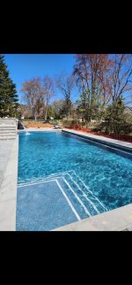

Wanted to report back to everyone. We did the acid wash yesterday to correct the footprints. It was a great success! Our pool builder instructed them to do it really "gently". So they didn't make it very acidic at all and only said they would make it more acidic if the footprints didn't disappear. The footprints were gone in about 12 hours. We called them and they came back and raised the level back to within normal pH over the span of a few hours. Process was easy and short and our pool looks great. Our wet edge prism matrix indigo blue color actually looks better than it did before the acid wash in my opinion. A little darker and with more pop. Exactly what we were going for. Will post more pics soon!
See attached pics!Screenshot_20230520_124318_Photos.jpgScreenshot_20230520_124318_Photos.jpgScreenshot_20230520_124323_Photos.jpg
