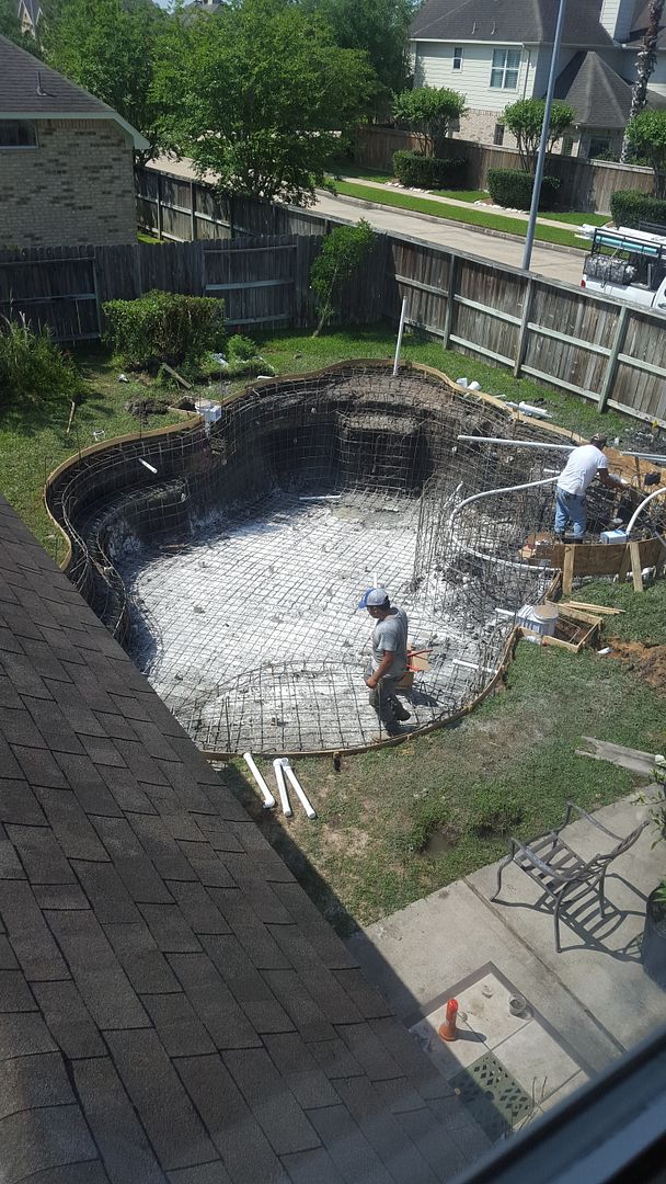

Rebar workers are here. :)

Yes, I hope it won't be a war zone too long. We desperately needed to do something with our backyard, because the dogs were tearing it up. This will be very nice and still give them space. It is getting hot and it's time for another walk for the dogs, but first here is a rebar photo.

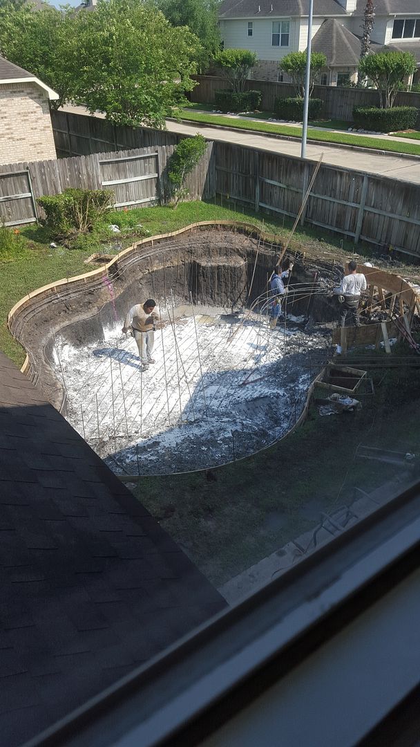

Already on rebar, when did the dig start? Took 3 days to dig our hole before rebar went in.
Dig was yesterday. They finished it by 3:30 p.m. and that was even with lots of breaks to wait for the truck to come back to get the dirt. They would dig, load it into the truck, when the truck was full it would leave and they would need to wait until it came back before they could start digging again.

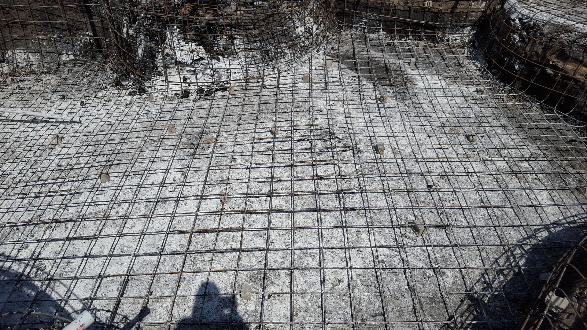

So I started another thread on bonding and will post this here as well. I learned today that there is more than one way to bond a pool. Our PB does it after gunite. They bend these tall loops down and connect the bond wire to it and then do the rest. Here is a photo of the loops and one showing how a loop is connected to the rebar.

Looks nice! Time to walk around the pool and look for a thick, copper wire clamped to your rebar. If it is not there time to call the PB and make him come out and put it on.
Kim:cat:
Already had a lengthy text chat with PB and they do it after gunite, so we are all good, but thank you for checking it was the first thing I went out to look for. :)
