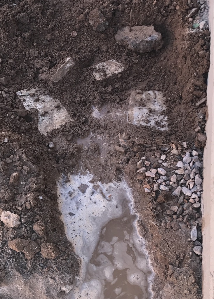

Here is what I found on the side by the equipment. They only ran the drain pipe a little beyond the edge of the deck, so water was collecting there. I tried to dig it out a bit to get the water away from the deck.

The plumber said you won't see moisture because it's on the suction side, so that lone isn't under pressure. No stakes or forms - I have pavers. It's $250 for one line leak detection. No telling how much the plumber will charge if it's not his fault. [emoji24]

$250 is really good. The plumber should be cheap and often won't charge for a simple fix as they assume you will complain to whoever broke it like the patio guys who in turn won't recommend him when someone asks for a plumber recommendation. It's the circle of life in pool builds...you fix my screw up and I'll shoot you business.
If the leak was caused by your paver crew, then I would back charge them the amount to detect and fix the leak. This is common practice in construction, even if it's not a fun route to have to take. If you haven't already, I'd start with a friendly call to whichever crew caused the leak and give them the opportunity to make it right.
