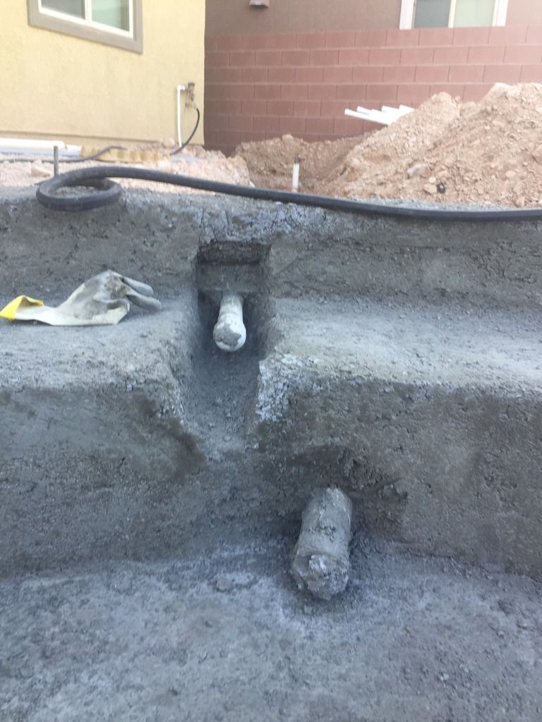

I have a return on a step and they did something that I'm not to sure about and I'm still waiting to see how it comes out once they cut the pipe and put plaster in.
I will say this, definitely have them put the step either right under the return or put the concrete directly in the middle of the return so it's not a eye sore. Right now mine looks like a eye sore and I'm a bit nervous
The top one is a return and the one I'm nervous about and the second will be a light which is right in the middle and looks fine

i hear ya. i totally thought of ur build this morning when i was thinking about this. i got a light that is hitting over a bench so that is deep so i should be cool. but ya i got a return and if it doesn't hit dead center it will be an issue i think. ur light that is in the middle is what i think a perfect senerio would be.
so what's the plan with the return that is cut into the tread?
i'm thinking what might save me is all i have are stubs right now. so it can be pulled that day and put back in where need be? i don't have full run of plumbing to the pad yet.
sorry i only got this poor photo. you can see the light at the bottom of pic over the bench. no issue i would assume. the return is the other pipe. again just a 18 inch or so stub.
what do you think?

I completely agree in that the light is perfect, once they trim the lip down and put the light it will shine perfect from the shallow end and look like it belongs.
I'm not to sure about the return and I HATE the way it looks. I know they trim the pipe down and if they didn't do the trench during concrete my thought was the worse that will happen is that the water will bounce off the steps and just create more surface movement. I do however know that it's even with all the other returns so it's needed for skimming and I'm not sure if it would be less effective if the pipe was 3 inches lower. I was told that this is common and not a issues and the experts here didn't see a problem so I'm just trusting and hoping it's ok.
Right now it's a eye sore but I hope that after plaster and all the fittings are in that it looks normal. I will definitely keep you updated. I will say that if I was in your shoes and seeing how mine looks I would ask that either they adjust it a few inches or make sure the concrete guys put the return in the middle of the step so it looks less intrusive provided it doesn't take away from the main purpose of the return.
