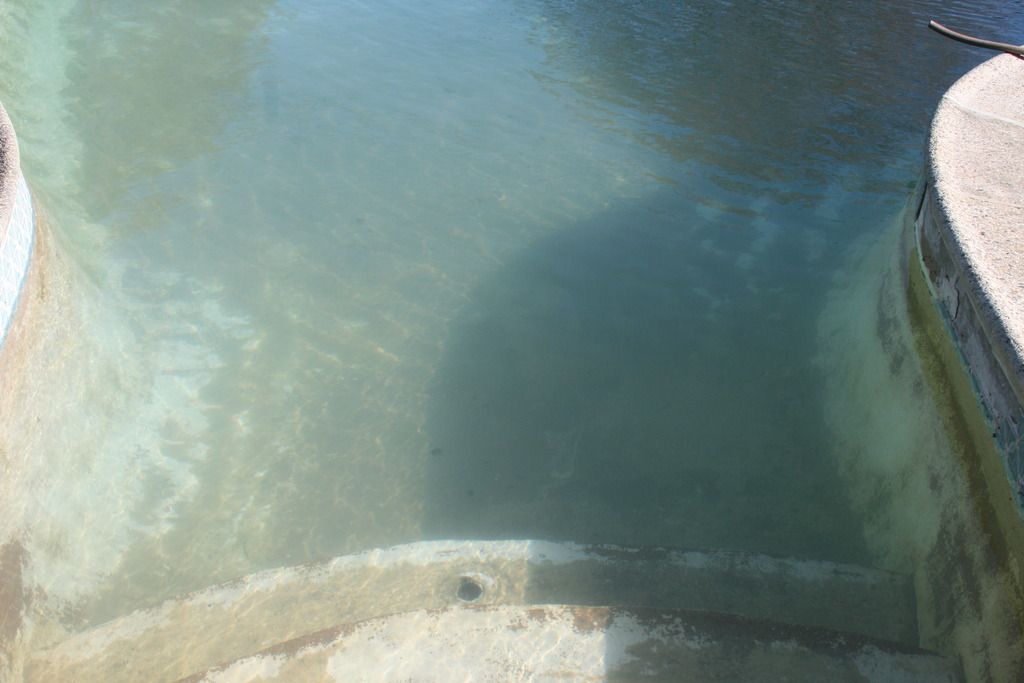

Here are the pictures from this morning. I have a sick child at home today and I need more DE. I don't think I'm getting out to the store today though...
The pool definitely needs painted, if not resurfaced. I'm not sure how to tell when it would need resurfaced.
Another Starting picture:
Day 5:

Re: New House came with a neglected pool - Starting SLAM 4/18/15!
There is a lot of fine dirt and a few leaves on the bottom. Should I vacuum that up through the filter, or bypass it?
I just wanted to post this question again since it was lost above - looking at the last picture posted, what should I be doing to get the bottom of the pool clean?
As far running the multiport set to waste or filter, I always vacuum on filter with my sand filter. Mostly because I have a single speed pump and if I vacuumed on waste, my pool would drop 4 inches in depth due to the very high flow rate. In your case, it's either doing lots of filtering, backwashing, adding more DE if you vacuum on filter or vacuum to waste and not worry about the filter. If there's alot of sediment and because you have a DE filter, I'd vacuum to waste if that's practical from a water standpoint.
