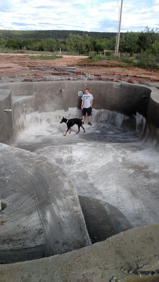

Hope your prevailing wind blows toward those skimmers. I'm not sure how effective having two skimmers, basically, next to each other is going to be.
As you can see in this pic, we have a skimmer near the sun ledge
as well as one at the other end of the pool (ignore the doberman, he abhors water).
The PB got it wrong. I had asked for two skimmers (one on each end) based on advice from a PB friend a little further north to us. We just opted to go with one instead of the two right near each other after they installed them. I'm hoping I don't regret giving up on this.
