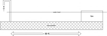

Here's a picture of the (raised) spa:
I'm really surprised by your statement that a HL could be buried in the wall even if it's a spillover spa: I don't understand the physics that would prevent the loop from being flooded, since the loop would be lower than the highest level of water in the spa.
I admit I'm not the strongest in fluid dynamics, but I really thought that the HL had to be higher than the highest point in the spa. This explains it better than I could: Pool Patrol - The Pool and Spa Professionals
There's obviously something I'm missing in understanding how HLs work... What am I misunderstanding?

Ah, I see your spa configuration now. From your original descriptionI couldn’t tell how far around the spill over went.
Do you have any photos from when the pool was constructed specifically showing the plumbing in the spa before the shotcrete work was done? That would be helpful in understanding your issues. Pool plumbers and builder can do all sorts of funny things and often times you don’t realize it until after they’ve collected their last check and are long gone, sadly.
Oh I think I see what you mean now: there are circular designs where the water level is lower that the topmost area, for example when there are notches for the water to spill through. In that case, it is possible to have some in-wall plumbing that is above the water line indeed. Thank you for sticking with me on this!
Unfortunately, no. It was like this when I bought the house. I did get the plans from the city, but I remember going through them a while back and saw designs that ended up not being implemented, so it's a mix of "we wanted to do this, but scratch that, we ended up doing that instead", so I don't really know what I can trust from that.
I know this was remodeled not too long ago, and the spa was added to an existing pool (which was also modified during the remodel), so the spa is relatively recent (~5 years?).
