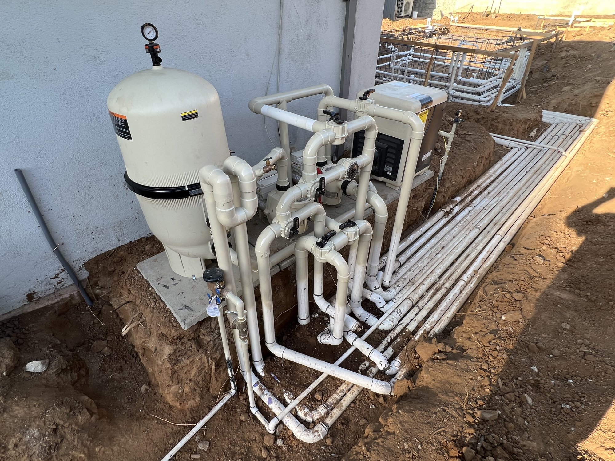

Would this be a spill that only overflows during filtration mode but no other time?
Can you expand on what you are describing?
My pool is in POOL mode filtering 24/7 since I run my pump 24/7 at low speed. POOL mode = filtration mode and is always filtering when the pump is running.
How to control that?
You schedule SPILLOVER to run for 15-20 minutes when you want to refersh the SPA water.
I run my spillover at 9:14 AM for 20 minutes to get chlorinated water in the spa for the day and then at 2PM for 20 minutes to refresh the chlorination.
Is it possible to program a separate run time for the spa to get refreshed, say at 2am or so?
Yes, you can schedule SPILLOVER to run anytime for whatever length you want.
