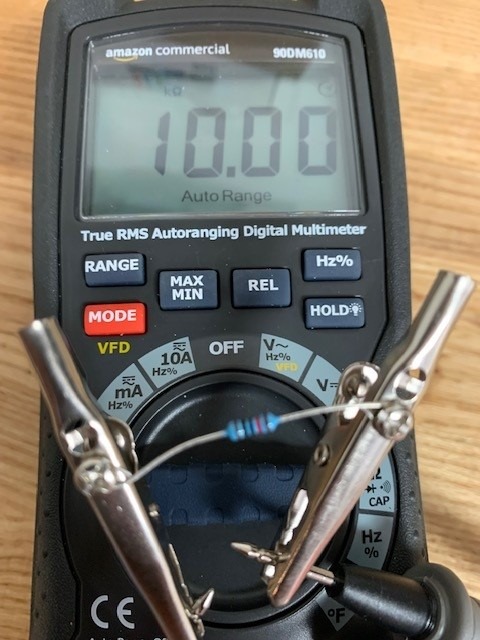

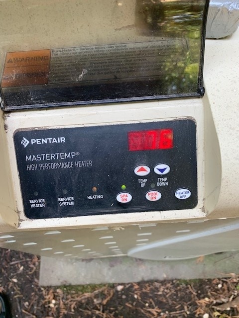

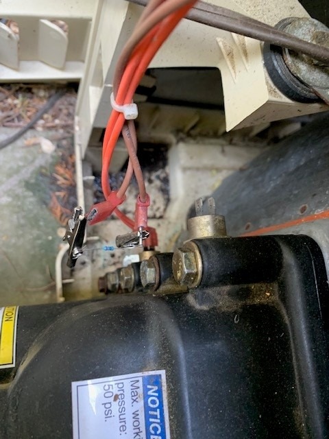

For a test replace the thermistor with a 10K resistor.
With the 10K resistor in place the heater should read at 76F while the Controller stops it at 100F.
If the temperature stays at 76F then you still have a problem with the new thermistor.
If the temperature drops or rises you probably need to check the wiring from the thermistor to the board, and maybe replace the board.
