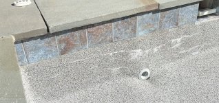

Thanks for the helpful tips! Here are some pictures of what I’ve got to repair.
Overall view of the pool (need to finish the playhouse I’m building in the background so I can get to fixing the pool): IMG_4754.jpeg

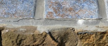

The main issue is cracking/leaking of the tile along the infinity edge. This leaking has caused most of the stone to delaminate from the dry side of the weir wall and delaminate the pebble in the basin. Everything sounds hollow when tapping on it.
I don’t like how the tile and grout was installed on the top of the wall and has cracked within 3 years of repairing.
My other main issue is a spa leak. I had some pool and leak companies come out and removed the coping stone to determine the cause. It looks like the pebble delaminated from the tile causing water to flow behind the pebble. The finish is hollow along this wall.IMG_4755.jpeg
I feel like I can handle all these issues individually which is why I’m inclinced to perform most of the repairs myself, but combined might be too much time.
Overall view of the pool (need to finish the playhouse I’m building in the background so I can get to fixing the pool): View attachment 610760
My other main issue is a spa leak. I had some pool and leak companies come out and removed the coping stone to determine the cause. It looks like the pebble delaminated from the tile causing water to flow behind the pebble. The finish is hollow along this wall. I have a single speed filter pump (separate from pool) with the return directed right at this wall. My guess is the heated water causes thermal shock resulting in premature delamination in this area.View attachment 610764
Cracks in the plaster are caused by shifting soil underneath/behind the structure, most likely caused by a long term water intrusion. The spa jet heating water would be way way way down on a long list of likely causes.
You need to fix the soil movement first by determining if the soil is moving because of the water leaking through those cracks or whether it moved first and caused the cracks (which are leaking more water causing further soil movement).
If you just fix the stuff above the waterline without addressing the leak, the repairs will just fail again, which sounds like you have already experienced.
