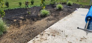

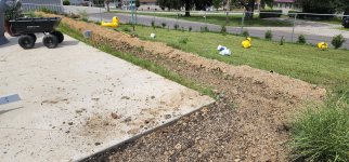

Started to backfill the trench. It's a lot of work for me on my own. I'm just going to do a little at a time until it's done. It's the only thing I can do. I got to the corner n quit. It's hot n muggy. I'm using up the 3/8" crushed stone chips from the pool build that's piled in the driveway.
