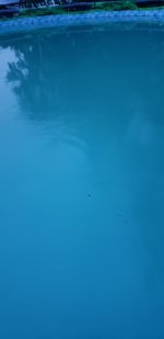

I have a 14x4 ft best way pool. We cleaned it out, filled it up in the water was beautifully clear for about a couple days. Started pouring bleach in. Had a little bit of a lapse where I was sick, pool got green. I have poured so much chlorine into that pool I cannot believe it's so cloudy. I dumped a box of 20 mule team borax in there, nothing. Test strip shows that the chlorine is okay range. CYA is very high.
My pool is a thick cloudy very light teal color. Help.

Ok then the test strips are dead wrong about your CYA. (Again, you need a relaible test kit)
There is no CYA in fill water, and if you haven't added any, it's still 0. WIth 0 CYA, half of the FC burns off in 2 hours and it won't last long. Leading to you spending hundreds.
Order a TF100. We'll show you the way.
Also, the smart stir makes testing sooooooooooo much easier. Fun even. Either add it to the TF100, or get the TFpro which comes with the smart stir and a nicer case.
Also, the SLAM option is great for newbs and those with swamps (you are 2 for 2). Both will be testing more than normal and blow through the standard supplies.
