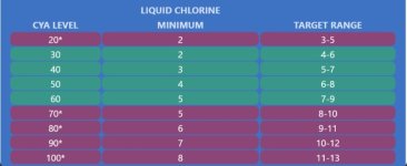

I am going to share a chart with you. Look at your CYA (Cyanuric acid - 65) to see what FC (Free chlorine: 0.22) you should have:
Now that it is hoping the pool store got your CYA level any where near correct.
Any time your FC (Minimum & Target Range) gets below the minimum level for your CYA you risk algae.
