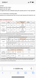

Also, in addition to my above note, I found this information of our city site from their water testing. These don’t seem high.

I do know when the pool people came and open my pool I told them to not put any chemicals in because I knew I wanted to follow the TFP method. But do you think they listen to me. He dumped in a ton of algicide. After I told him about all the issues I was battling he mentioned that some of the products he used us metals in it. Made me mad!
