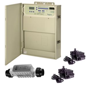

Thanks Dirk, do you have a link to those bundles that I can take a look?
