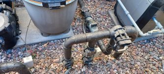

Relatively new at Salt Pools, I tried removing my Jandy Aquapure PLC1400 the last time and I nearly drained the spa. When I loosened the couplers the water started gushing out. I thought it would just drain the filter but it kept on and on until I put the couplers back on. I had the neighbors pool guy come over and when he removed the couplers the water trickled a little and stopped, I was shocked because it was gushing just an hour earlier.
Whats the trick to removing the salt cell so that it doesnt siphon out all the water from the spa?

Be sure your automation is in pool mode - not spa mode.
Fully close the spa make up valve as well.
Post a few most pics showing the entire equipment pad in each shot from a few different angles.

It is the line to the left of the actuator on the return side. Has a check valve in line.
