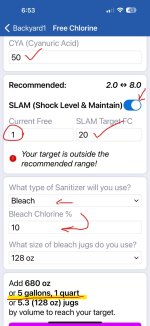

Now I am trying another App from Clorox called CLOROX POOL, which shows a CYA of 50 (see pic below). And I like it.
I got the point, based on the SLAM theory, shock chlorine level is determined by CYA & FC relationship.
By 1, 2, 3; --> Bang! I got 20 ppm of FC!!!!!! (Click here: Free Chlorine and Cyanuric Acid Relationship Explained)
Sounds about right.
Then I use POOL MATH, click FC calculation, oh the CYA has already factored in. Great, I need ~ 5G+1Qt 10% liquid chlorine!
I will do it and keep you guys posted!

Yes, you are very kind. My own assessment just like drive a loaded (hopefully bleach) truck into the pool and hope to kill all the screaming algae and bacteria!
Indeed, Chlorine has been used as chemical weapon during the WWII. Huh huh, wish me good luck!
I can't let this go - one app shows you at 79, another shows you at 50. So go to 20 or 31 for SLAM? Did you just waste $30-40 by putting too little in? Nobody can tell you.....
I will take it CYA of 50. My understanding is:
Keep pool water clear is actually a very straight forward job, threw a bunch of disinfectant (in this case it's the chlorine, or TC/FC) into the pool, it will stop the algae growth, pure and simple.
But, the trouble is how much! Too much will bleach your swimming pants, too little will not kill the bugs.
Seemingly simple job will frustrated enough to puzzle the PhD student, firstly because it's entangled with the pH. The potency of chlorine is depended upon the acidity or basicity of the pool water.
Secondly, the sun light will decompose the chlorine, therefore, this is how the famous cyanuric acid (CYA), the "chelation agent" come into the picture.
