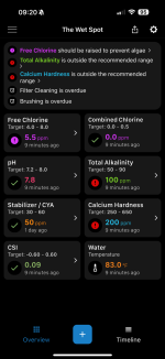

Thanks. No min on FC though it did go down slightly. I’ve attached this mornings results. I used the SpeedStir. I am still struggling to nail down my CH. I cannot tell when I should log it, it’s either around 200 or 250. Also, my TA appears to have raised a bit. I added the recommended level of LC but am debating on whether or not to do a MA treatment. It seems like it may be time.
Use 225 until it appears otherwise. We don't need to nail this one, although we do strive to be as accurate as reasonable. But we need to know the general CH, that it's 225ish and not 800 or 50.
Its probably close. And here's the deal. Don't lose sleep over it. If you dose a bit early at 7.8, next time comes a bit earlier. If you dose after couple days late at 8.2, PH is a long term concern and no harm was done in the short term.
It'll settle where it wants to be. Maintain the PH and monitor the TA to see how it responds.
Whelp, I went ahead and added the suggested amount, following TFP recommendations. My first MA addition ever (since pool stores have said specifically to not use MA but to use dry acid). Fingers crossed this goes well!
