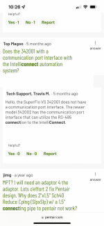

The IntelliConnect cannot control the SuperFlo VS. Says so right in the manual.
Jim R.
I am reading so much different information that’s why I posted on TFP. Saw this on the Pentair questions portion of website. I have the newer model and some type of port on the side of my pump. I do not know if it is the RS485 port though.
Do you have the manual for your pump? If so, take a look at Page 5. This capture is from the manual posted on Pentair's site for Model #342002. The revision date on the last page of the manual is 10/8/20. See the first note...
I would try to contact Pentair directly and inquire. Point out the inconsistencies and info from the manual.
Here's a recent thread on incompatibility. Maybe you can message or ping the OP, @bubby4113:
Off,
There are two different "confusions..." :scratch:
The original SuperFlo VS did not have an RS-485 port, so obviously could not be controlled by any automation system over the RS-485 com port.
SuperFlo pumps built after 10/15/20 should have a fully operational RS-485 port. This seems to work with other Pentair automation systems, such as the EasyTouch, IntelliTouch, and IntelliCenter, but the SuperFlo VS manual specifically states that it will not work with the IntelliConnect.
As brought up in the links by Mike above, some Pentair techs have unfortunately said the new SuperFlo will work with the IntelliConnect, when they really meant that the new SuperFlo VS pumps have an RS-485 port, that works with other Pentair automation systems, just not the IntelliConnect.
