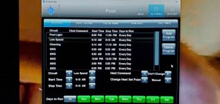

Enz,Now I just need to figure out why my pump won't stay running. Something is causing it to shut off prematurely.
I think that the "don't stop" setting under egg timer fixed it. It hasn't shut off since.
Pool = lowNot that is matters, but I do not understand your SWG programming at all..
Did you rename "Pool" as SWG? Or did you rename "Pool" as Low Speed?
